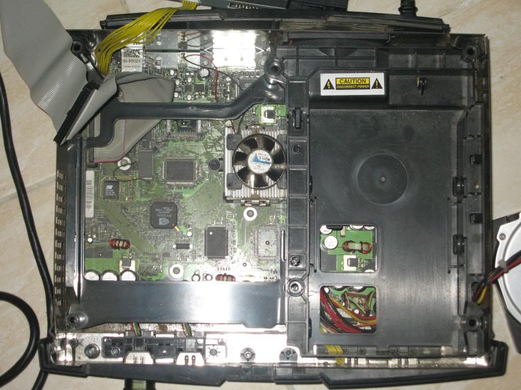

spmatrix
  • Posts: 9
Error 16
« Reply #8 on: March 03, 2013, 12:10:00 AM »
I was one of the first since the xbox came out and created the first (or second) chip.
I do not know how it looks this chip, so I can not know if it has a switch or not.
I will try to make a photo.
Heimdall

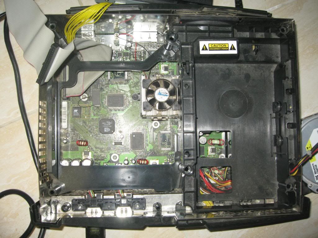

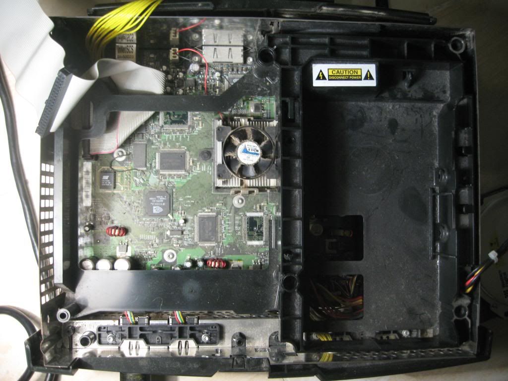

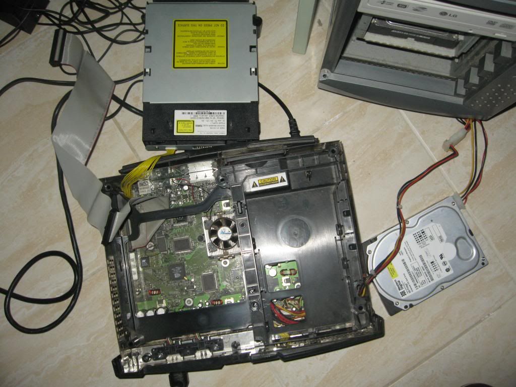

Heimdall
  • Posts: 3862
Error 16
« Reply #13 on: March 03, 2013, 11:48:00 AM »
I meant photos of the chip and the immediate area around it, not repeated photographs of the whole Xbox.....
There is no evidence of a switch, so that option is out of the question.
Have you got hold of Frosty's or HeXEn yet, and burned them to DVD-R, and tried to boot with them?
Have you built an xboxhdm CD to rebuild the hard drive (like the one in the Youtube video you linked to)?
Also, do you have a spare IDE hard drive?
spmatrix
  • Posts: 9
Error 16
« Reply #14 on: March 03, 2013, 12:03:00 PM »
My friend, I told you that I do not know what is Frosty's or HeXEn and what they are doing and I can not find them.
Explain to me.
I downloaded the recovery disc and tried as I said and as shown in the video but with no result.
I can not proceed. While recognizing the hard disk when I press the first option, I get an error message, like there's no hard drive.
Third, I do not have extra hard drive.
I can buy one, but the size is large, around 160gb
