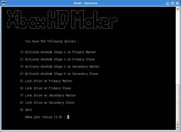

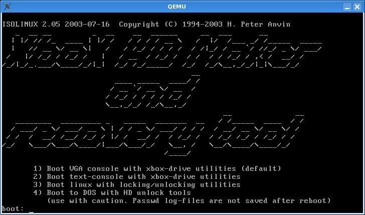

i never saw these menus:
(IMG:http://i235.photobucket.com/albums/ee226/dballs442/xboxhdmenu1.jpg)
(IMG:http://i235.photobucket.com/albums/ee226/dballs442/xboxhdmenu2.jpg)
though this ^ one is familiar from 1.9.
and the i saw a different but kinda similar menu as the first pic. as well as other menus.
