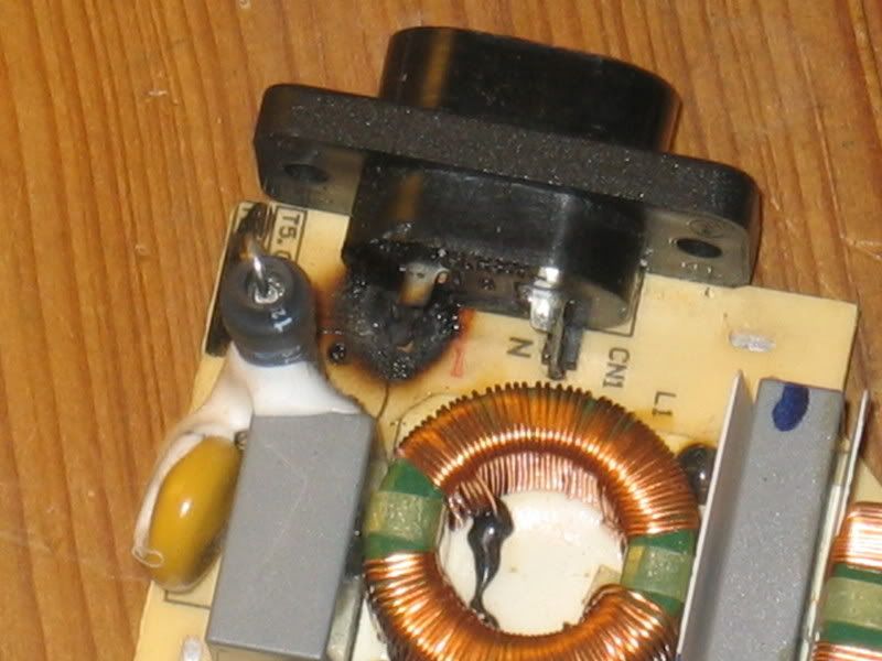

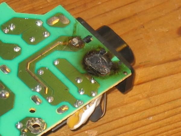

Update! My own damn Foxlink power supply just burnt up on me. You know, the one I repaired in my first post (pics are currently down due to using up my bandwidth). Fried the same as everybody else's.
I can't post a pic directly, but here's a link.
bottom
top
edit- nevermind, thoke links dont work either. Should be back up tomorrow.
This post has been edited by G0t M4xx 21: Mar 23 2005, 08:15 AM
