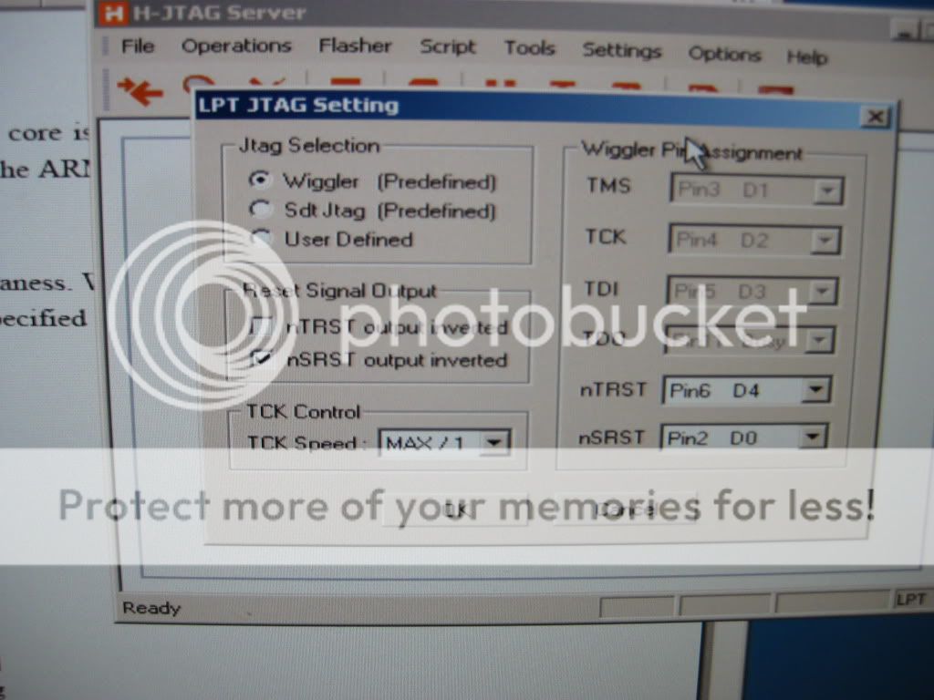

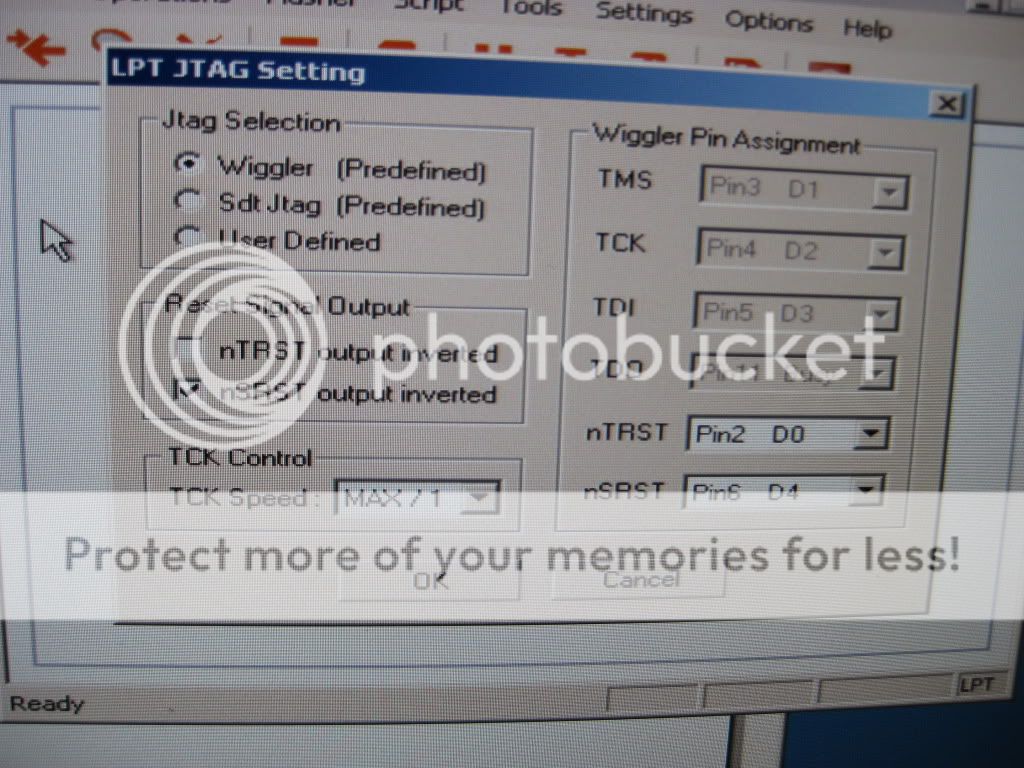

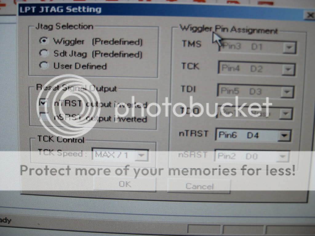

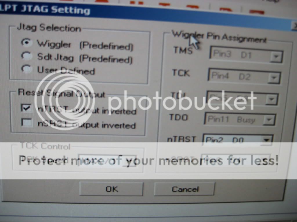

As you previously wrote, the website states this:
To set up H-JTAG to work with the ARM-JTAG, use Jtag Selection "Wiggler (Predefined)", Reset Signal Output "nTRST output inverted", nTRST "Pin2 D0", and nSRST "Pin6 D4".
So the nTRST and nSRST are inverted when compared to the screenshots previously shown.
Try setting these again and let me know what happens. It's a little strange that the config is inverted to that of the Olimex wiggler tho!

OK - seems like I've never checked my settings!
I have it setup with
nSRST output inverted - yes
nTRST = Pin6 D4
nSRST = Pin2 D0
Here's the official Olimex JTAG Wiggler: http://www.olimex.co...v/arm-jtag.html
And the IDC layout: http://www.olimex.co...jtag-layout.gif
Compare to the layout from the site you bought yours from : http://microcontroll...be1908d25a337c6
They're the same - therefore you should have your LPT JTAG settings as mine above.

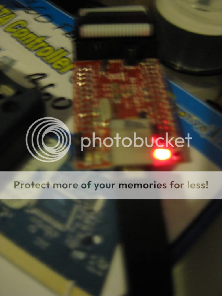

Ok so for an update. I got the wiggler off vv on ebay and it works great. Detected it right away programmed it in about 2 minutes and its ready to go as best I can tell.
It gives me the cant detect flash controller message in nandpro which means I'm good to go if I solder it up right? Much appreciated on the Tut and all the help you have given out! I don't know for sure but I don't think the green light was lit up when I used this wiggler... It was lit green on the actual wiggler device but its def not on now on the 2148.
