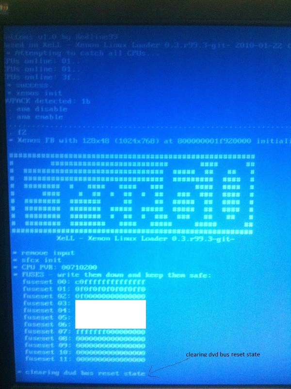

i've updated xell to xellous by putting updxell.bin to usb stick. It updated fine but now it boots up and stuck at showing "clearing dvd bus reset state". Any idea what it means?

QUOTE(akumi @ Jan 26 2010, 06:48 AM) View Post
Are you doing a virgin hack?

« Reply #54 on: January 28, 2010, 06:49:00 AM »
a virgin hack? i've done a few and they work fine. For this problematic one, i've even flashed back original nand and tried it again but no luck.

« Reply #55 on: January 28, 2010, 12:31:00 PM »
ouch I would say you have a corrupted dumped then...

« Reply #56 on: January 29, 2010, 06:12:00 PM »
lol actually the xbox 360 was already not working properly that's why couldn't get it to work. Anyone come across this problem? When you put a game in and it doesn't play, it just loads up blank screen, but plays dvd fine.
Note: the drive has the correct dvdkey and also the drive is brand new working on another xbox 360.
