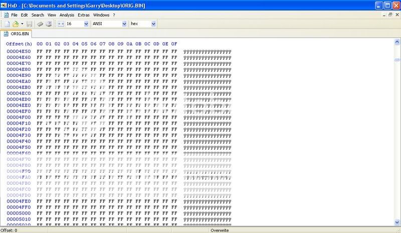

I have an xbox360 that has a drive labeled as ms25. The motor on the drive is having major issues. I thought I might use this guide to replace my broken drive with an extra Lite-on that I had laying around. This is a brand new Lite-on that I collected back before you could flash them. I took it out of a box and put in a sammy for that person so I still have the extra Lite-on and all the files collected during the dump.
So I have dumped the firmware from the ms25 in this box and when I load it up in firmware toolbox this is what I get (now keep in mind that this drive works in the console if I manually put a burned disc in it so the FFFF stuff is weird)

I've dumped plenty of ms25's before. I'm not sure why I get the FFFF. It looks like its dumping just fine. I've tried with mtkflash and dosflash with the same results. I'm wondering if this box first had a hitachi in it and this ms25 is spoofed as a Hitachi (from the firmware toolbox results that's what it looks like)
Other than mtkflash or dosflash is there any other methods for dumping that ms25 firmware?

The drive's not a Hitachi. It's an ms25. It's just weird that after dumping with both mtkflash and doshflash that it comes up like that in firmware toolbox. I have tried other orig.bin's that I have backed up from other drives and they come up right. I have verified now once again that burned games work in this drive. Weird that I can't get a proper dump.

Seems very strange to me
Is your drive recognised as a TS-H943A  in dosflash as the pic below shows
The key location in your bin file shows 4F00 that is for a Hitachi ver 59
and you would get ffffffffffffffffff if it was a TS-H943 firmware as pic shows
for a TS-H943 the key can be in one of three places as shown
use a HEX editor and have a look at the key position in these places
the pic below shows the key as 88888888888 because i have changed it you can see it
is at location 401A but fw toolbox will just round it off to 4000
so your key position in fw toolbox should show 4000 for a TS and not 4F00 for the hitachi
