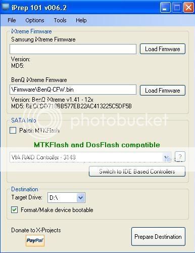

As a bare minimum you must have the benq xtreme firmware on your iprep boot device this will contain
Dosflash you don’t need Samsung extreme firmware but if you have it it’s still ok
(IMG:http://i409.photobucket.com/albums/pp176/buddy6_photos/iprep.jpg)

a lot of people use iprep to make a boot disc for benq and samsung
sansung uses mtkflash and the 10 seconds trick we are not using that method
so if you have got this on your boot disc thats ok
but we are using dosflash that is only set up on the boot disc by loading the extreme benq
all that is required relly is to have a boot disc with dosflash on it
using a iprep boot disc contains dosflash in the tools folder
we use dosflash in auto mode to flash the ms28 very easy

I used iPrep to make my bootdisk, however, in the tools folder, all I see is:
FirmTool
MTKFlash
MTKFlash.typ

have you loaded benq xtreme firmware into iprep you need to load this because it sets up doshflash
oh I see. I just copied dos flash manually into the tools folder.
In your screenshot you are using dosflash 1.6, which is not part of iprep anyway (they use some older version).
I have a VIA 6421A card, so I think dosflash 1.6 is the better choice anyway. I hope this thing lets me revive my bricked samsung ms25 drive. Any suggestions?
yes thats ok copy dosflash in the tools folder
what i was trying to get at was people make a iprep boot device , usb or floppy
they can then use this boot device to run dosflash in auto
if you load xtreme samsung into iprep it only gives you mtkflash in tools folder
but if you load xtreme benq it will give you dosflash in the tools folder
In any case when you make your ipep bood device it is recomended that you update mtkflash
and dosflash and firmtool on you iprep boot device because  these progs might not be up to date
yes dosflash in auto mode will sort your ms25 out

geodeath
  • Posts: 22
Lite-on To Ms25--ms28 Using Dosflash16
« Reply #14 on: November 18, 2008, 01:27:00 AM »
thanks for the reply!
thats exactly what i am doing.
1) dump orig.bin (the firmware on the ms28)
2) apply ixtreme 1.4 on it
3) replace key with key.bin from the liteon (maybe not correct key? it IS a key however, not CCCCC)
4) spoof the drive with inquiry.bin
5) check it says all of the above in firmware toolbox
6) put in on the stick
7) flash it with dosflash
8) put it in the 360 and try some discs.
2 things come to mind. The first thing is that the drive is dated at 2006. It never came with a real xbox, but alone from an eshop. Which makes me think it might have a problem with either the laser or something else.
It had an FFFFFFFFFFFFFFF key (empty). However, if the laser had problems or needs tweaking of the pot, would dvd movies PLAY?
The second thing i can think is that probably the key extraction was not 100% correct. I can try dumping it again and comparing. I HAVE an xbox360 with a sammy that WILL work given its totally new but i only wanted to flash a drive for my second 360 that comes with an HDMI port. Because if i take the samsung from that xbox i will still need to replace its drive, which is just a little better than doing nothing! smile.gif
Maybe the samsung is problematic, i dont know.
If the drive was not spoofed correctly would it even boot?
