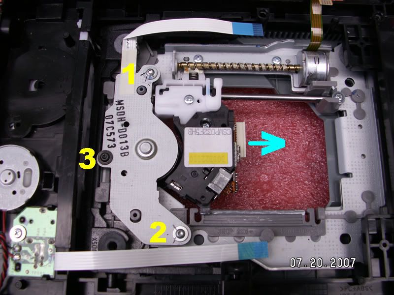

You need a Spindle motor from another 360 Hitachi drive.
It's easy enough to do, the flex cable just unplugs from the board, be careful with it though when reinstalling it, and there are only 3 screws that hold the motor place. The thing ya need to watch though is the 2 outside of those 3 screws are also what adjust the tilt/pitch of the disc, so ya need to mark the heads of them so ya get them back close enough to where they were or ya may have issues with the thing reading the latter half of dics.
You'll need either a 1.5mm Allen (Hex) wrench or a Torx T6/T7 to get the screws out. Alternately a small enough flathead screwdriver can be used, though I don't recommend that, but it'll work if need be.
Mark one with a 'Y' and the other with and 'V' or whatever works best for ya, but do each one differently so ya know where that screw goes, and mark it all the way thru the head of the screw an onto the motor bracket some, so ya can tell which goes where as well as have that 'point of reference' to get back to. Best way to get it back as close to the default setting is after ya mark them snug them up the rest of the way, paying close attention to how many 1/4, 1/2 or full turns it goes past the markings until they are snug, then remove them, when ya put them back in place all ya have to do is snug them back down, then back them off the number of 1/4 turns or however far it was until you're back at the original position, where if all was done right it'll be lined up with your markings ya made. The center screw (number 3) doesn't have to be adjusted at all, it just comes out, then gets put back in place like any other screw. Slide the laser assembly back a little bit, just give it a gentle push, and then out the motor comes.
The 2 outside screws (number 1 and 2) also have springs under them that are under the motor bracket, so be careful to not loose them when ya take the motor out. Have the drive upside down when ya take the screws out and motor loose so they don't go who knows where on ya.
The Logic board is removed in this pic, but ya don't have to take it out on yours to replace the motor, ya can if ya want to, but it doesn't need to be.
(IMG:http://i50.photobucket.com/albums/f320/RDCXBG/360%20Hitachi/HitachiMotorQuickTut.jpg)
This doesn't apply to your drive, but is for anyone with a Samsung drive that's replacing the motor. It doesn't have any tilt/pitch mess to deal with, that's done elsewhere, and it's motor just gets removed and replaced and has 3 Phillips head screws that hold it in place.
