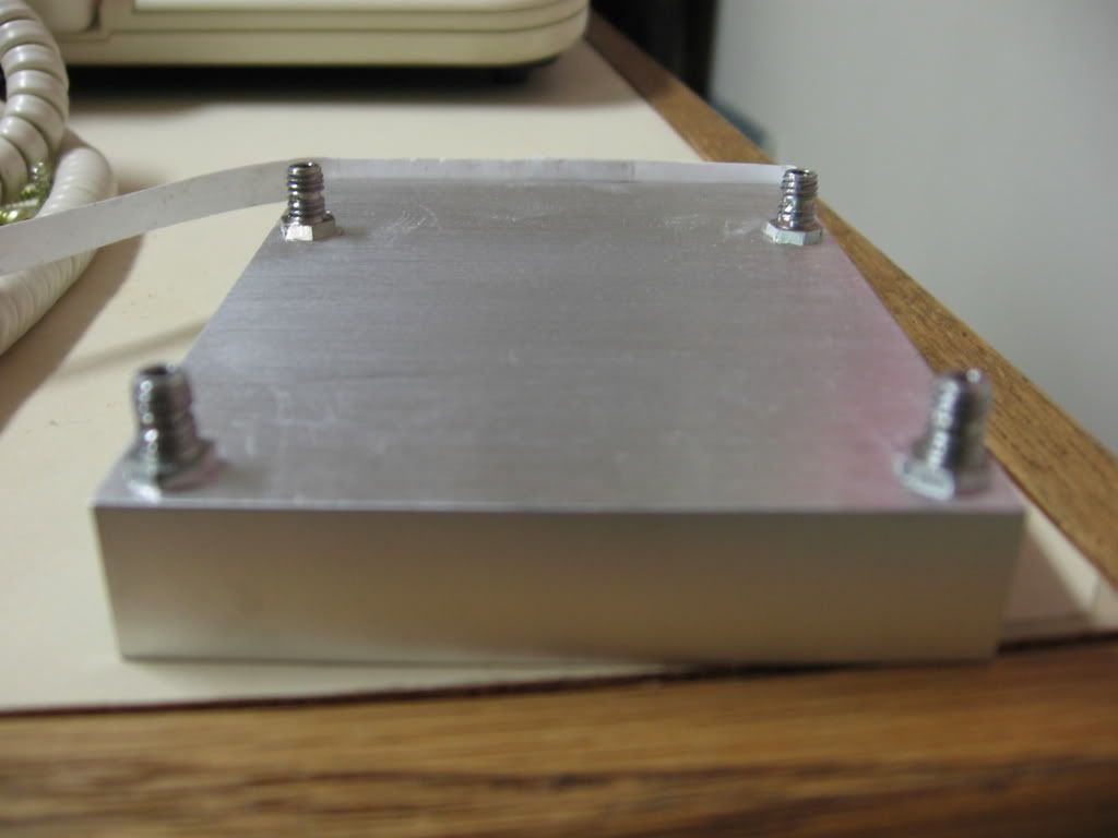

1.you'll need to thread the legs of the GPU/CPU (doing this isn't hard , I'm not going to go into details on how to do it. just ask for a few tips when purchasing the kit, If you still have trouble PM me )
it'll look like this after heat sink legs threaded

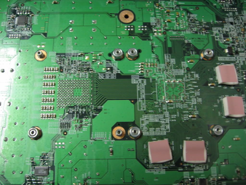

2. here's what it should look like installed under mobo
under mobo 2

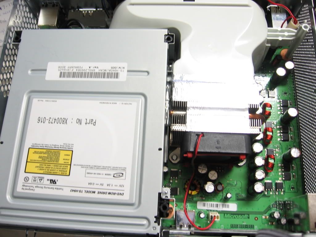

3.re-assemble and test. It'll work without using the heat gun usually , but if not then you'll need to use the heat to get it going again , then screw everything back tegether and you should be ok.
4. This is where you use the heatgun option (if necessary). again , I'm not going to go into detail on doing this as there are other tutorials already. I also don't want to hear it if you think this is a bad idea, it works for me , so no amount of talking is going to convince me otherwise. So, do it if you like or not, I'm just telling you what I've done that works.

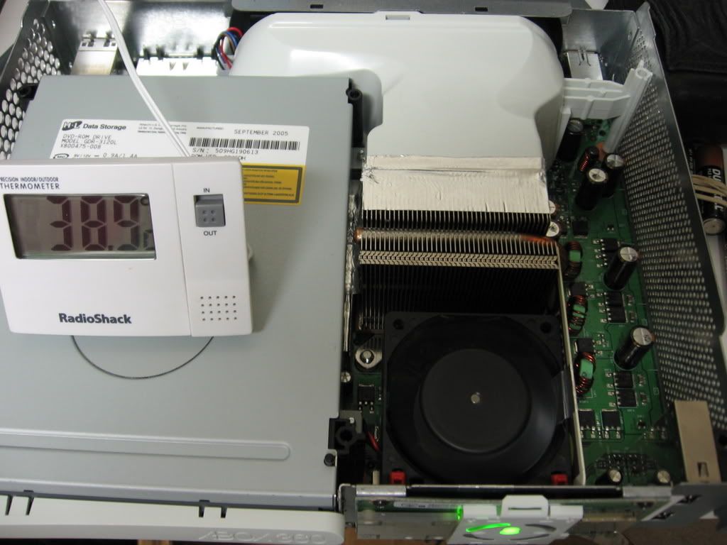

5.This step is also a good idea as well , although it isn't absolutely necessary. put some spacers on top of the GPU chip ( I didn't use this on the cpu , but that's just me). something like this AMD foam pads
I found that using an eraser provides pretty good consistency to give firm pressure to the top of the chip while not being too hard that it won't compress and give a good contact. be carefull when doing this step, if you make the spacers too thick the heatsink won't contact the chip and you'll get overheating problems.

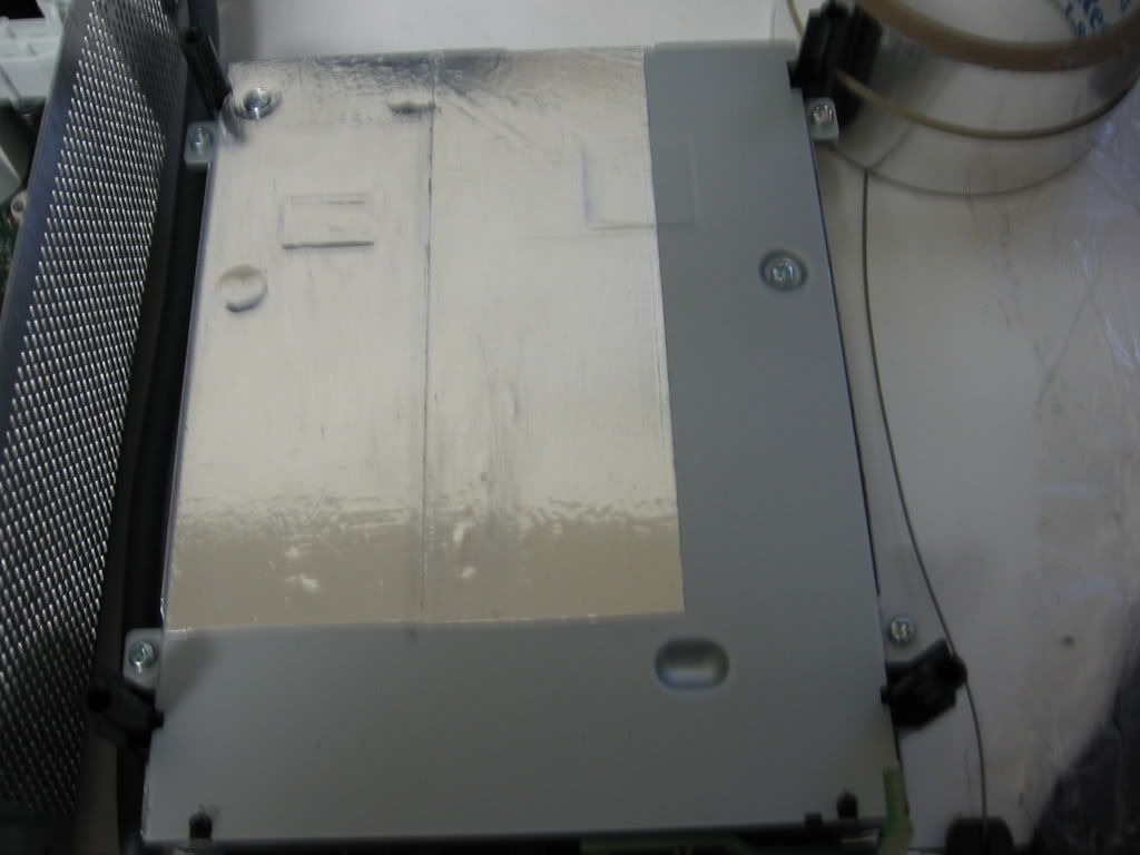

also, heatsink tape and under dvd drive

the nut isn't going to damage the mobo because they are a bit rounded where they meet the mobo. the nut tightens without grinding because both surfaces are pretty smooth. when you tighten it you don't need to apply so much force that you snap the bolt.
The only thing I think you need to do when doing this is tighten opposite corner nuts , just to keep things perfectly flat.  I also recommend torquing them down in increments to keep it consistent , instead of cranking the first one all the way down and moving to the next.

if you look at the pic you'll see that the nut only comes in contact with the board right where the coper is. it doesn't touch any of the traces and that's the main concern. but yeah, if you wanted to you could put some washers or some tape if you were worried.

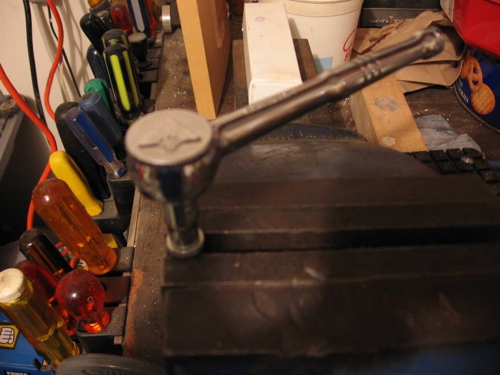

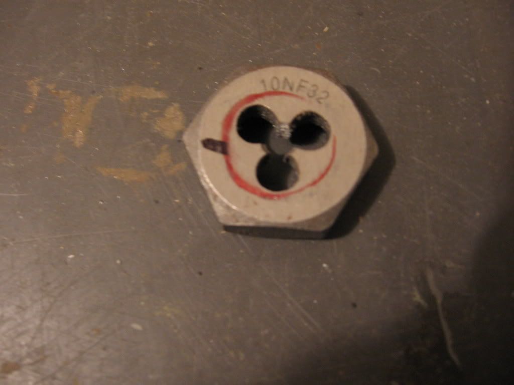

I've had some PM's asking about how to cut the threads so I've put some pics up to clarify things.
This is the die needed to cut the thread 10-32 die
here's the nut needed (or equivalent locking nut) nut

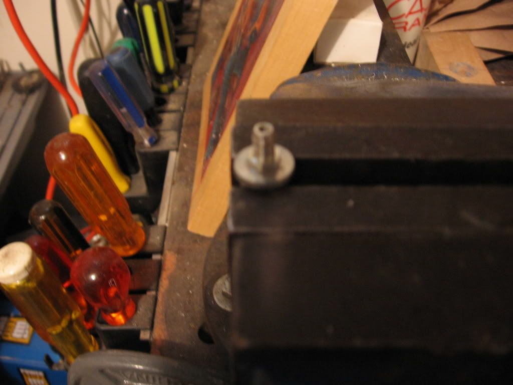

remove the standoffs using a 6 point socket.  or pliers , if you want , but I think you'll damage them if you use pliers.

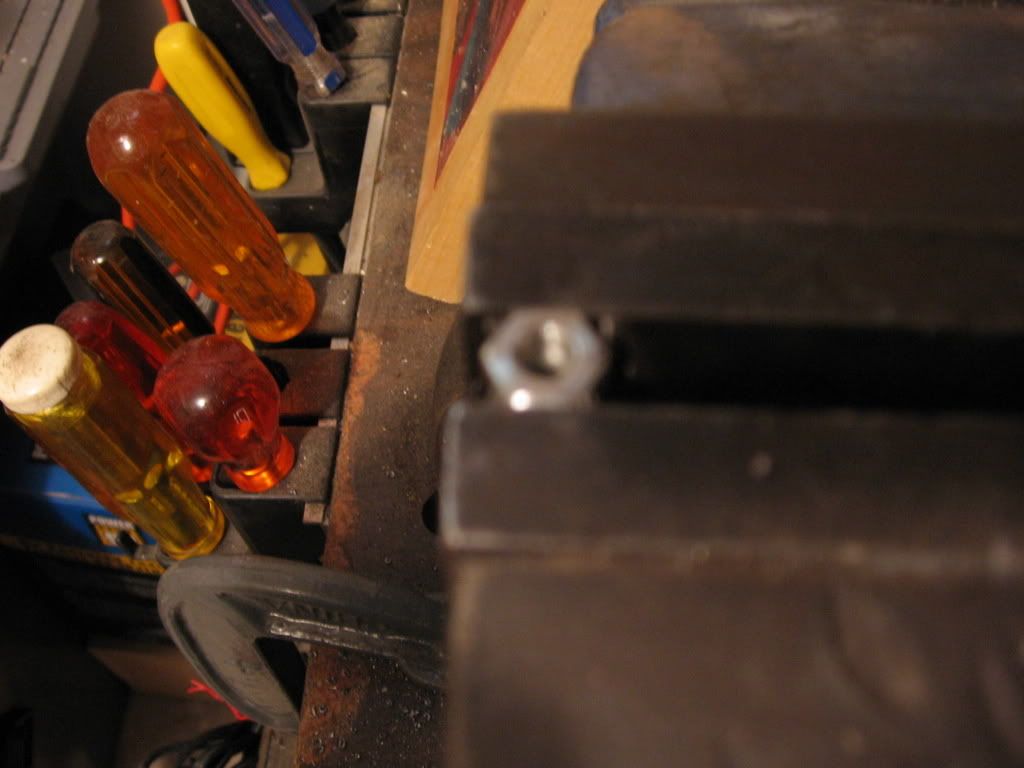

place a nut into a vise and screw the standoff  into it to hold it while cutting the thread.
nut in vise
GPU standoff
make sure to tighten it so it doesn't spin while cutting , but not so much to strip the thread.
ratchet

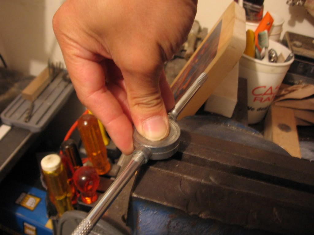

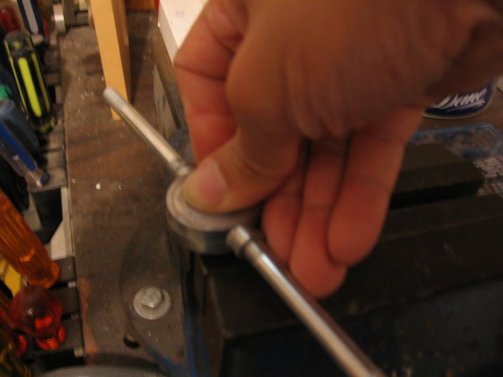

place die over and apply steady downward pressure while turning(doesn't need to be a lot of pressure, let the bit do the cutting)
cutting
cutting 2
cutting 3
make at least one revolution cut and then it should start cutting without the nedd for downward pressure. after a couple of turns , back the die up 3/4 of a turn to break the cutting away , then start cutting again.
if there's anything that's needs more explanation feel free to PM me or post here..
