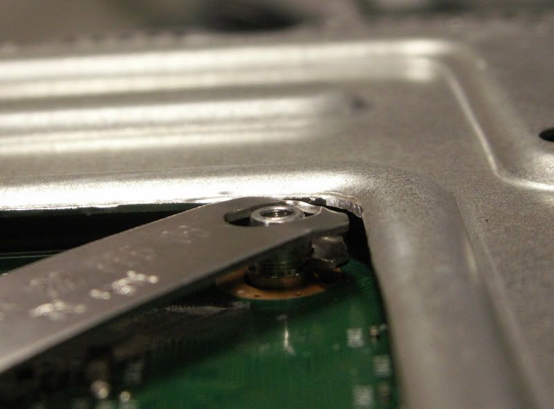

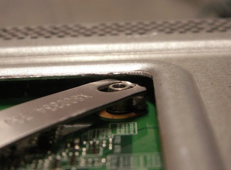

I think that heat gun trick is a 50/50 shot at best, and is probably warping the board doing more bad than good in the long run. I had my 360 torn down for a few weeks getting into what caused my 3RLOD 0102 error and the heat gun did squat for it but bring it back for a little while. Even after I got my real Hot Air Rework setup and reflowed everythingthe right way with the right tool it still didn't revive it. Mine had a slightly bowed board that when it was all together was pulling the board down from the GPU heatsink just a hair. That whole X-clamp AND screwing the sinks to the case is about a half brained idea in the first place, one or the other is fine, not both. I had to hack out the back of the case where the X-clamps sit, so when it was all back together the board didn't bow and the sink stayed on the GPU. I set my fans to run at 12v and I've had not one issue with the bloody thing since then.
WHAT IT SHOULD LOOK LIKE
(IMG:http://i50.photobucket.com/albums/f320/RDCXBG/360%20SUX/XClampsCPU2.jpg)
WHAT IT DOES LOOK LIKE
(IMG:http://i50.photobucket.com/albums/f320/RDCXBG/360%20SUX/XClampsGPU2.jpg)
Take it all apart and set the mobo on something that doesn't conduct, then plug everything back into it and see how it runs. Make SURE you keep the fans on it and set them so they blow on the GPU and CPU sinks and it'll be fine for testing purposes. If it runs fine that way and ya have no issues, then put the mobo back in the case and see if it sits in there perfectly flat, or if it "rocks or tilts" at all. If it does I'd say it has a similar issue as mine.
BUT, since you say yours only does this from a cold boot that leans more toward a crappy solder joint somewhere though, hence why it starts working after the heat gun and there's no problems while it's running, but that's the flip side of what I though was wrong with mine,it would die after running for awhile, but only together and it was fine all apart. You may want to have it redone by someone that has a rework setup and see if that produces a better result. I wouldn't take too many more trips to the bench with the heat gun on the board, you may be making it worse.
