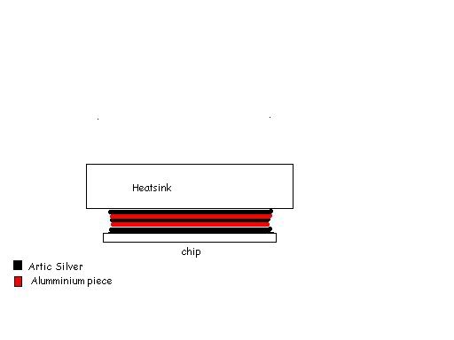

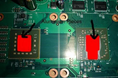

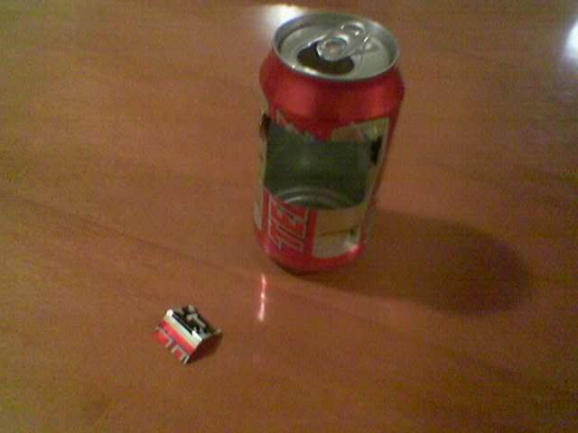

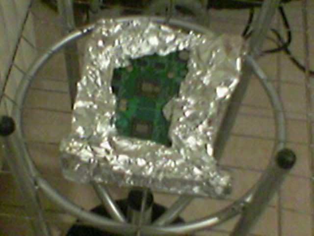

« Reply #154 on: January 19, 2007, 09:09:00 AM »
QUOTE(Darth Darius @ Jan 12 2007, 10:58 AM) View Post
Well after my 9th time to do the heat gun trick and , last just a few weeks with middle play, i decide to buy another 360 (with extended garant. course) after a month , with my head cold , ill do this with my old , and death 360:
i "cook the modbo like this":
http://i140.photobuc...pg?t=1168622456
Sorry for the quality its a cellphone!!!
Thinking in just do the same "repair", but in the time ill drink a cold tecate beer i just see my refreshing drink an say "aluminium", i finish my beer an cut a piece like this:
http://i140.photobuc...pg?t=1168622771
well i cut 2 pieces and fold them to get thiknes, in the form of the ram and the other chip, put some artic silver and put between the heatsinks and chips to create pressure, be careful to cut exacly the chip form to avoid short cuts, put it back together an tested for 3 weeks, i got the brand new 360 stored under my bed, if you got nothing to loose, try this!!!
Cheers!!!!
Well today this fix run up for 4 weeks!!! yesterday, my day off, i play 3 hours of gow, 2 hours of Batlle for middle earth, see a movie, 1 hour of oblivion, and no crashes!!!! ill think this works!!!!
Cheers!!!!!

Darth Darius
  • Posts: 13
Xbox 360 Problems Might Be Due To Manufacturing Issues
« Reply #156 on: January 20, 2007, 10:14:00 AM »
QUOTE(davidrose9 @ Jan 20 2007, 05:16 AM) View Post
It would be nice to know what this trick is in layman terms i see the pictures of cola can cut up and a ton of foil what the heck is this trick share it please. Is this like the toothpick trick I still cannot find but keep hearing about how it works help us out with more info on these fixes?
Well Davidrose , you do the heat gun trick first, as you Know , i did it with the two heatsinks off,  then you cut the alumminium can like the picture in the form of the two chips under the heatsinks, (just the plastic form), in the next pic , http://i140.photobuc...r7/Modbo360.jpg, watch for no put the piece in the small capacitors , just in the plastic like the pic, the pieces must be 2 for each chip to do the job done, put some artic silver in the chips, in the first piece to do a "sandwich" between pieces , this help for no moves when you installing the heatsinks
like this http://i140.photobuc...gengar7/Fix.jpg
when you put the heatsinks and put the screws the heatsink do pressure over the chip and prevent the fatal error.
