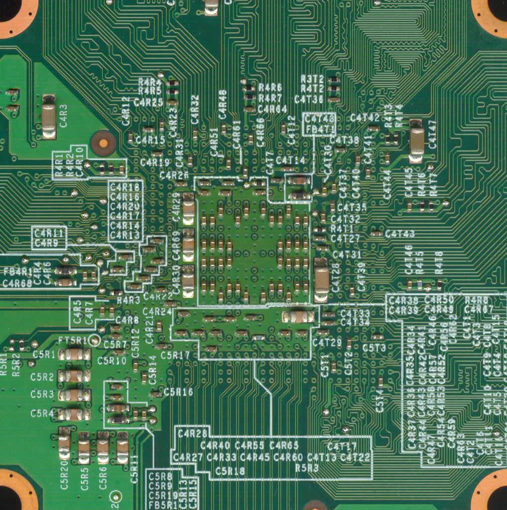

RDC
  • Posts: 3913
Xbox 360 Problems Might Be Due To Manufacturing Issues
« Reply #141 on: January 02, 2007, 06:20:00 PM »
QUOTE(wizer @ Dec 28 2006, 09:49 PM) View Post
Started with the 3 red leds. Did the heat gun trick 3 times and finally got the box to boot, but then later got an error 74. Took the xbox back apart and noticed that there are 3 of the small resistors on the bottom of the mobo under the video chip missing. I Guess maybe I got it a little to hot.
If someone could tell me what these are and where to find them, as impossible as this sounds, I am would like to try and replace these.
Without knowing which parts are missing it's impossible to even try and tell ya what they are. What are the board designations of the ones you have missing? They should be labeled RxRx or RxTx, x will be a number like R4R5 or R3T2.
This is a scan of the bottom of the board right under the GPU if ya nee something to compare yours to.
