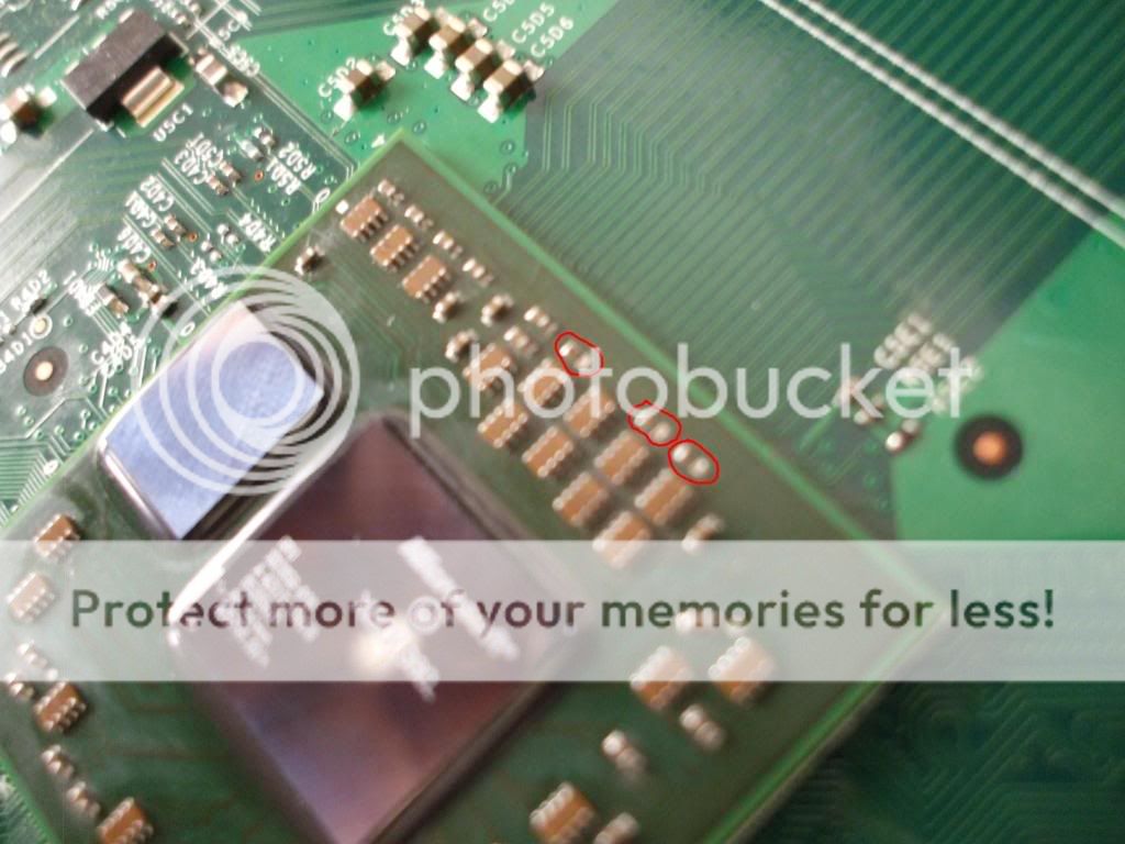

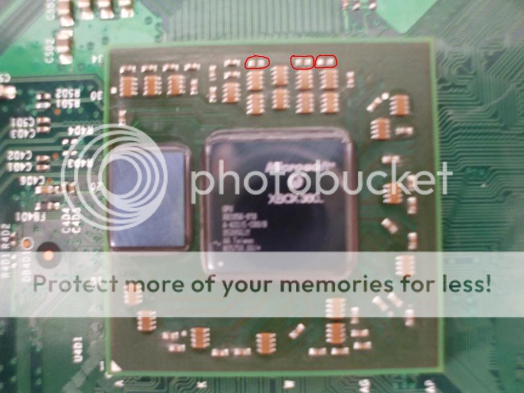

Xbox 360 Motherboard Component List
« Reply #64 on: September 22, 2009, 08:08:00 AM »
Ok, so here are some actual pictures of my own GPU... hopefully someone can help me determine the capacitance on these caps and tell me where to get them. I'm thinking about going to Digikey, but who knows at this point.
(IMG:http://i454.photobucket.com/albums/qq265/autumn321_01/editt.jpg)
(IMG:http://i454.photobucket.com/albums/qq265/autumn321_01/edit.jpg)
Thanks in advance for any help.
Cheers
~ Duditz
