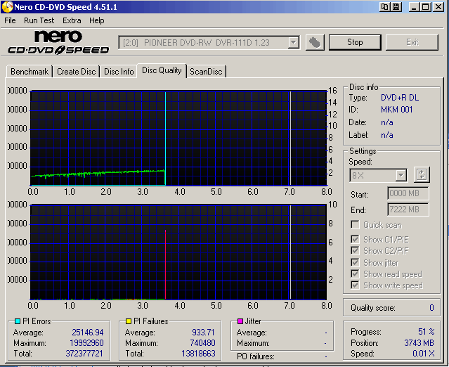

ILLusions0fGrander
  • Posts: 3560
Post Pi/po Error Scans Of Your Backups
« Reply #13 on: August 10, 2006, 06:45:00 PM »
this doesnt look good, but it got here and stopped almost.. i was running a lot of stuff in the background, reinstalling a lot of progs after new Mobo install... but here it is:
pioneer 111d with 1.23 fw
verb 2.4x
WinbonD
  • Posts: 118
« Reply #14 on: August 10, 2006, 07:10:00 PM »
as you can prabably see from your picture ,
the 111d does not work properly with the cd/dvd speed yet
