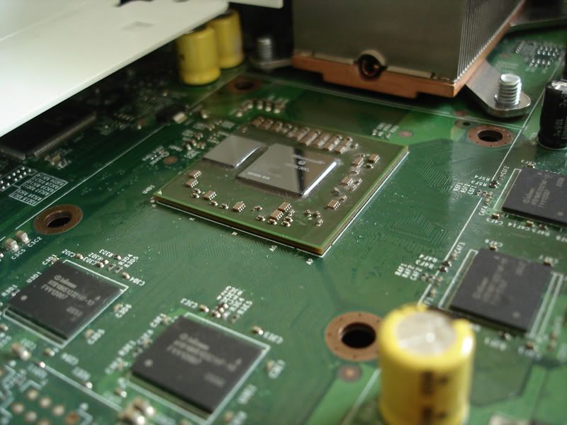

« Reply #25 on: April 04, 2008, 01:59:00 PM »
Alright so I have cleaned the GPU. Which part of the chip do I heat exactly?
(IMG:http://i13.photobucket.com/albums/a268/ghy135/album%202/timechangegpuchip.jpg)
I know I will need to remove the white plastic and fans but Im planning to heat it next weekend so I have time.
And should look for a specific heatgun or will any heatgun get the job done?

« Reply #27 on: May 09, 2008, 01:40:00 PM »
There's a very good tutorial on Google Video for doing the heat gun. BTW, that's a beautifully cleaned GPU.
