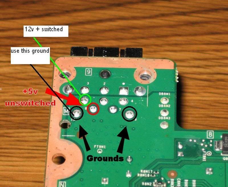

here is what i did.....my internal lcd wip
and I used the power from under the power plug on the bottom of the mobo.......rike zis
