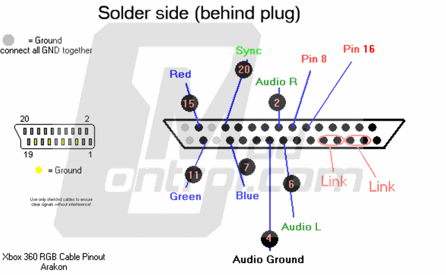

for the pinouts, i think you will have to do a little searching. i dont think there is a complete pinout diagram aviable yet. ill do a bit of searching, and if i find one, ill add it to my photobucket account and post it here for you.

well this is the best picture that i could find. im not sure if it is what you are looking for though.

ok tried it and it works great many thanks for all your help and for hostin this pic and for savin me some cash...im off to try and wire an xbox1 headset adapter into the line of my planatronics headset as i dont have a vol-on/off switch for my headset as i didnt get a 360 headset. if anyone has a diagram for the old xbox1 headset adapter so i know where to solder the mic/earpiece wires and earths it would be very very very much appreciated.
