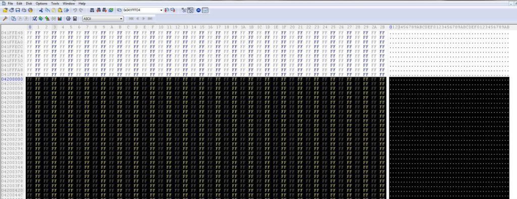

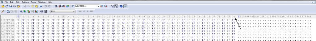

For anyone like me who has dumped their jasper 512 with nandpro with only the flash portion and can't extract with ibuild heres a quick fix. My original dump was 68.0 MB (71,368,704 bytes) in size but the goal is 66.0 MB (69,206,016 bytes).  Make a backup of your file before going forward. Open the one you plan on using in a hex editor and make sure the ruler is extended to 2b.
(IMG:http://i128.photobucket.com/albums/p167/whackawookie/Snap5.jpg)
now click edit and choose goto, in a hex format paste 041fffd4. Make sure everything beyond this point is null (FF).  Once you confirm, highlight from the row directly under ( so from 0420000 on)
(IMG:http://i128.photobucket.com/albums/p167/whackawookie/Snap6.jpg)
all the way to the end and hit delete.  Save the new file and confirm the new size is 66.0 MB (69,206,016 bytes)
(IMG:http://i128.photobucket.com/albums/p167/whackawookie/Snap7-1.jpg)
Throw the new file through ibuild and everything should extract fine now.
