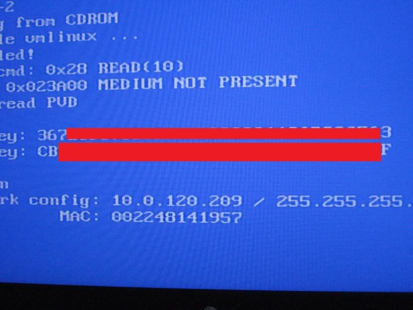

dstruktiv
  • Posts: 204
Complete Guide To Installing Xbreboot For Noobs
« Reply #42 on: December 09, 2009, 07:49:00 PM »

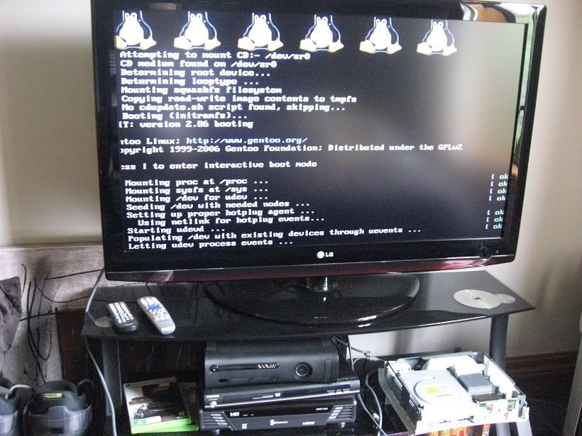

QUOTE(Cascade @ Dec 10 2009, 09:13 AM) *
So after  I do this- then I can do a JTAG hack- to get my CPU key(so I at least have it incase anything)?
Yup, after XBR has been written to the nand using this guide, you can then boot in to Xell by plugging a wire controller in to the back usb port on the 360 and powering the console on by pushing the middle X button on the controller.
You'll then see Xell load up and it will clearly say:
CD Key: XXXXXXXXXXXXXXXXXXXXXXXXXXXXXXXXX
DVD Key: XXXXXXXXXXXXXXXXXXXXXXXXXXXXXXXX
Take a photo on a digi cam then you can write the key out in to a text file.
(IMG:http://i18.photobucket.com/albums/b145/Powerslayer/IMG_2007.jpg)
More pics...
(IMG:http://i18.photobucket.com/albums/b145/Powerslayer/IMG_2001.jpg)
(IMG:http://i18.photobucket.com/albums/b145/Powerslayer/IMG_2002.jpg)
(IMG:http://i18.photobucket.com/albums/b145/Powerslayer/IMG_2003.jpg)
(IMG:http://i18.photobucket.com/albums/b145/Powerslayer/IMG_2004.jpg)
(IMG:http://i18.photobucket.com/albums/b145/Powerslayer/IMG_2005.jpg)
And some Linux...
(IMG:http://i18.photobucket.com/albums/b145/Powerslayer/IMG_2010.jpg)
(IMG:http://i18.photobucket.com/albums/b145/Powerslayer/IMG_2011.jpg)

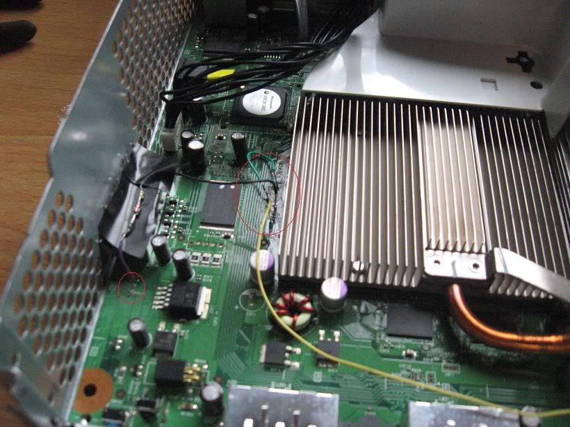

I got an xenon motherboard and set it up like this:
http://img19.imagesh...nondiagram.jpg/
I have dumped the nand 8 times now, compared all of them with HxD (a hex editor) and none of them are even close to each other.
I have resoldered 3 times.
Yes, i do have an explotiable CB and unupdated kernal.
I noticed at the end of each dump there are alot of 00's and FF's. I know this normally means empty/bad data. So which one is it for this? Are there suppose to be FF's and 00's at the end of Xenon dumps?
Should i Possibly use usb reader? I've heard about them, but ive never seen anything about them. Do you make it or just buy it or what?
I'm completely stuck and its getting very frustrating, been working non it for a couple of days now. Someone please help x.x
