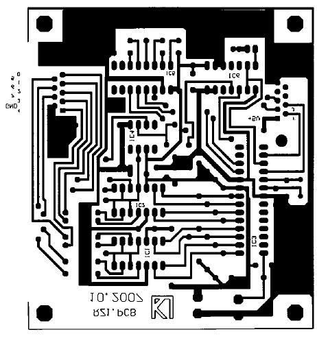

Hi, i made a PCB layout...
that will ease up the DYO a lot. for people who cant wait for the infectus stuff...
here are the high-res PDFs to do it. bottom layer:
Bottom layer PDF
here comes the top layer (a few bridges need to be soldered)
Top layer PDF

QUOTE(robinsod)
Dont use that one its wrong, the 10K resistors on the outputs of the comparators should be pill ups NO pull downs - he got R20 right though Wink
Use the 9.50 boot loader I posted a link to at the beginning of this thread, the 9.0 has a bug (cjack noticed).
i have attached the correct diagram (IMG:style_emoticons/default/smile.gif)
