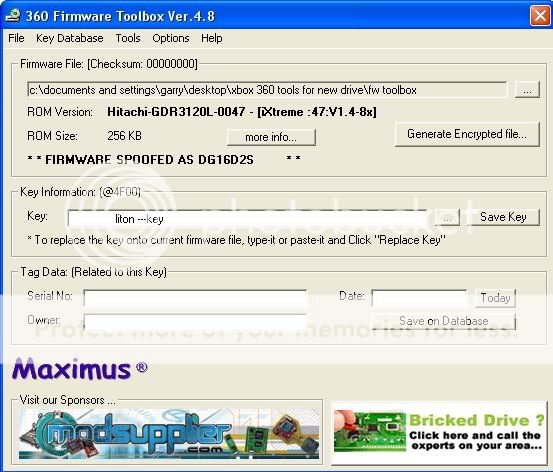

open fw toolbox and dump your hitachi firmware or use stock firmware that comes with fw toolbox
open up in fw toolbox copy you key.bin from lite -on , use smart hack patcher  to patch you drive spoof with inquirey.bin
If you fw bin file looks like this then go to
Tools /direct drive flash/differential flash patch/click on use classic mode to read differences click read
and detect differences if everything looks ok no errors then flash drive
my picture shows ver47 but yours will be ver46
Good Luck[lol its ok this will work fine used it many times
(IMG:http://i409.photobucket.com/albums/pp176/buddy6_photos/NewPicture9.jpg)

I cant be far off as my toolbox looks the same as yours but with 46DH but there is one bit which seems to be of concern.
I have followed the tutorial off team executers CK3 support /swap liteon for other drive.(dont want to post a link)
This tutorial shows the first opened file as ixtreme.bin, you mention opening the orig.bin firmware from toolbox folder? this could be where i am going wrong.
Here is my interpretation of what you are telling me buddy6
1. open firmware toolbox
2. open 46 firmware from origfw folder
3. locate extracted key.bin (liteon) and insert.
4. tools/smarthack patcher....."ruleset "ixtreme 1.4" "output file" saved to my location then "generate"
5. Hacked file then opened
6. spoof this file with inquiry.bin tools/spoof firmware/custom/inquiry.bin
7. Tools /direct drive flash/differential flash patch/click on use classic mode to read differences click read
appreciate your input mate, sometimes the harder you look the harder it gets it just needs someone to make you regather your thoughts and start afresh.

yes that is correct do that you should be ok if your ver 46 has not been flashed before

ok you dont keep the keys already on the drive because you are going to replace the keys

Buddy6  worked a treat  (IMG:style_emoticons/default/biggrin.gif)  thanks very much for help
