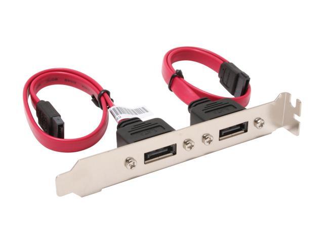

Yea, that's a perfect mod for for firmware updating.  Aside from the slight [generally hidden] aesthetic penalty, it's perfectly functional.  I actually did this mod a few months back by taking one of these things apart and applying it:
(IMG:http://images10.newegg.com/NeweggImage/productimage/12-206-003-07.JPG)
Mine's a bit less aesthetically pleasing yet, but even easier to use because i dont have to remove the hard drive.
