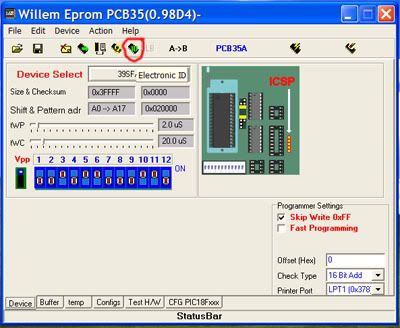

It seems the VF isnt supported on the willem (or at least on mine) , however after doing a few of these no with no problems, selecting this setting works, i get a good dump (heh heh) , and am able to retrieve the key with no problems.
(IMG:http://img.photobucket.com/albums/v251/thecheekymonkey/xbox360/078FK%20tutorial/ID.jpg)
Now press the "Electronic ID" button a pop-up should appear giving you the Chips detail i.e. manufacturer -  chip type - serial etc etc ,  make sure it displays this correctly, if it doesnt, remove chip and re-seat, repeat process till it shows you your chip ID.
once it shows your chip ID READ THE CHIP, THEN SAVE IT AS (EXAMPLE) "078ORIG.BIN"

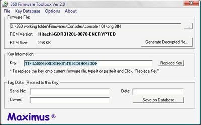

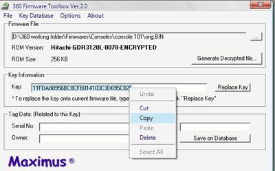

Once you have a good dump (excuse the pun) open it in firmware toolbox 2.0
(IMG:http://img.photobucket.com/albums/v251/thecheekymonkey/xbox360/078FK%20tutorial/open_orig.jpg)

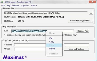

Where it displays the key, copy it.
(IMG:http://img.photobucket.com/albums/v251/thecheekymonkey/xbox360/078FK%20tutorial/copy_key.jpg)
Then open the "78_16.bin" file from 078 hacked firmware package (1.6) and copy the key into the key box.
(IMG:http://img.photobucket.com/albums/v251/thecheekymonkey/xbox360/078FK%20tutorial/paste_key.jpg)
Hit "replace key" once done click ok.

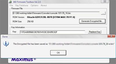

Now press the "generate encrypted file" button, this should then encrypt the hacked firmware which contains your key, and leave a new file in your folder called "78_16-.bin"  this is the file which you will program to your chip.
(IMG:http://img.photobucket.com/albums/v251/thecheekymonkey/xbox360/078FK%20tutorial/encrypted.jpg)

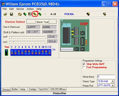

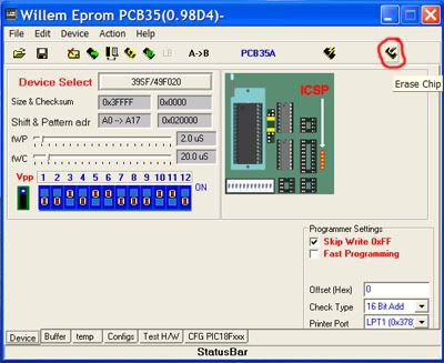

Now erase the chip ( i do it a couple of times)
(IMG:http://img.photobucket.com/albums/v251/thecheekymonkey/xbox360/078FK%20tutorial/erasechip.jpg)
Then do the "blank test".........let it run, make sure it verifys that the chip is empty.
(IMG:http://img.photobucket.com/albums/v251/thecheekymonkey/xbox360/078FK%20tutorial/blanktest.jpg)
