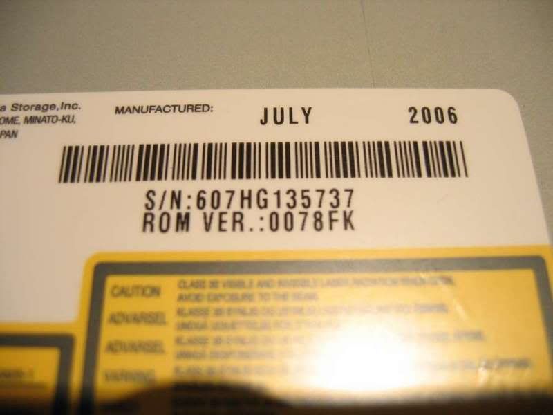

I've had a couple of Hitachi 0078fk, it gets detected in dos but not in windows unlike all other previous versions.  I use the Xecuter kit set to mode b with SiS sata chipset.  DgrMouse did your PC detect the drive under Windows? What Sata chipset do you use, and how did you extract the FW? Anyone else has other useful info to share?
Mine did not work under windows I have a Silicon chip I used the Xecuter Kit.
Here is my drive
Textbook
