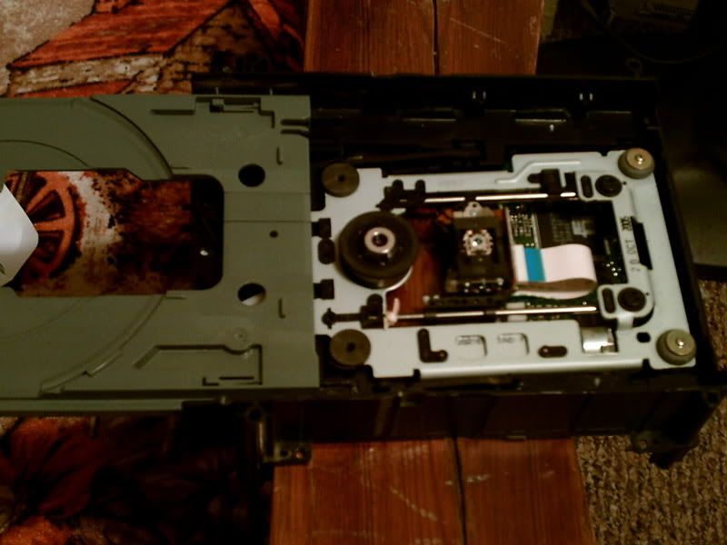

QUOTE(mrjkwik @ Sep 24 2006, 11:36 PM) View Post
just going by what i saw in that pic, a rubber o-ring may work.  or a stiff rubber washer.  just gotta find ones small enough, and split them.  just an idea.
hmm that might work.. but o-rings would slide around unless they were super tiny that fit snug over the chrome track piece.. give it a try see what you come up with

Update!
Ok as many of u would have read, i WAS having the dreaded Open Tray Problem.  My 360 has a samsung fw28 drive in it which i flashed with the xtreme 3.3 hacked firmware.
My backups are done with a pioneer 111D with vebatim dual layer +r discs, burnt in clonecd at 2.4x.
ORIGINAL games always booted, from cold of after i had been gaming for hours.
BACKUPS are different...  All of my backups will boot from cold but i found that after the xbox 360 got a bit toast after say an hour of gaming, if i tried to swap to another backup disc i would get the open tray in dash.  i would either a) have to let the xbox cool down for 2-3 minutes cool.gif keep opening and closing the tray and after around 5 goes the thing would boot.
Naturally i thought it was a heat issue and so i went out and bought the nyko intercooler.
Inititally i was excited i gamed with my saints row backup for an hour and then switched to another backup and it booted.  However after heavy gaming this weekend i foudn that the open tray error was still there.  all backup discs would give the open tray error after a while.  The xbox 360 was running a lot cooler however smile.gif.
Hence i started to think this isnt a heat issue.  So today i thought POT tweak.  went out and got a cheap multimeter and tried to do the pot tweak.  sadly the multimeter wasnt sensitive enough to read any resistance so it was useless.  so i put the xbox back together and was gonna wait til tomorrow to get a better multi.  Then i saw the rubber band fix.
Now when i start up a backup, i can straight away tell if its gonna give me an open tray as it makes a grinding noise a sec after insertion.  JayQue reckons this noise is cos the laser is reading too far into the middle of the disc, which does make sense.  why it doesnt do it with originals i have no idea.  also there might be a heat issue, making the laser read the wrong area of the disc when it gets warm.  who knows.
anyway his suggestion was to put a band as here:
IPB Image.
which i did.  initially nothing would now boot, not even originals, all i got was a terrible grinding noise.  JayQue then suggested that my band was too thick and the laser was now reading too far from teh middle.  Following his advice, i untied the rubber band and cut it in half lengthways.
My final rubber band was now about 2mm wide and about 1mm thick.  i then retied as shown in the pic, cut of excess and prayed.
Originals and backups now booted.  Strange, even adding a little distance, doesnt affect booting? smile.gif
So i have just gamed for an hour on saints row, then swapped like crazy.  NO Open Tray.  Time will tell but i think i finally nailed it!...
Full credits for my happiness and open tray fix goes to JayQue.  THanks mate for helping me out on irc as well smile.gif
Hope this helps u guys.  ntloser i reckon u should try the rubber band and dont try the pot tweak, this way is safer and works for me.
I am still glad i got the intercooler as the 360 runs a lot cooler and should hopefully stop it from burning out! smile.gif

QUOTE(mrjkwik @ Sep 25 2006, 03:21 AM) View Post
do you still get any "grinding" noise at all?
hmm not really, just the normal disc sounds that i got when things booted up normally.
ntloser, disconnect the dvd drive from the xbox and remove it from teh case.
then remove the 4 screws.  now u can remove the metal casing on either side of the dvd drive.  Next slide the tray open and orientate the drive so it looks like the picture above.  You can slide the laser unit down so that u can have more room to work with.  Now u should have plenty of space to tie the rubber band around the metal rod...
good luck dude.  if u need more help i am on efnet irc (Mana).

Hi,
Yes I got the top off and I see the laser lens assembly and how it moves on the metal rods.. I am just to sure where the rubber band goes.. Does the rubber band attach to 2 places and pull the assembly.. or is it just tied to the rod preventing the laser assembly from moving all the way to the center post

JayQue
  • Posts: 14
Open Tray Error After So Long
« Reply #68 on: September 24, 2006, 09:26:00 PM »
thats not mana's picture its mine.. as i found the fix.. and its a perm fix as long as the rubber band stays in.. i dont see why anybody would want to go through the trouble of inserting an original every time just to play a backup..
anyways.. here is a picture for you blind bats with it circled and the "arrow" to show where its located

« Reply #70 on: September 24, 2006, 09:32:00 PM »
Thanks I got it. I got the elastic in there and it is playing back ups and originals.  I guess thats it?

« Reply #72 on: November 23, 2006, 04:29:00 PM »
An alternative to the rubber band: I used 3mm of PVC earth sleeving.  Undid the bar at the "other" end, slid it back, put the sleeve on, slid the bar back into place and re-affixed it.
Note: undo the small Philips screw, not the big plastic nut thing on the top side as this is preset to a certain position.  When refitting, put the black bit back in the right way round (it'll drop into place at the right position, anywhere else it'll look bent or just wrong).  If the bar now has about 2mm of play at the end you undid, you haven't lined the black bit up properly so unscrew it and try again.
