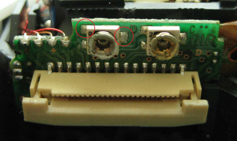

For Liteon drives there so few there who had problems. I had small problems, but only with traxdata discs, lousy/cheap ones, but i did give a try.
Flashing the drive was a bit tricky, but did manage. All is working just fine with verbatim discs. Traxdata gave some reading problems so i tried to adjust the laser.
From 5.29 to 4.72 and ill be testing some time now before i go any lower just in case.
Image attached for the Liteon measure locations:
ps. Adjust pot with a friend, unless got 3rd arm.
