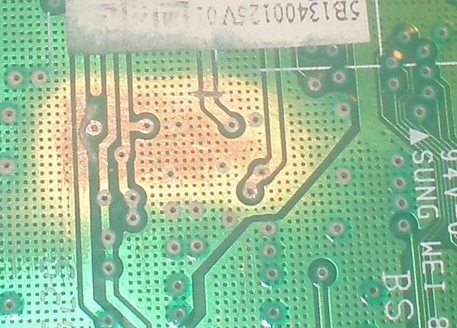

I am trying to retrieve the key of my liteon drive 7series to flash with LT+. I am using the probe V2 with the ck3 pro, since its the only way to get the key as it was previously flashed with the older LT firmware. The problem is that i am following the jungle flasher instructions on how to retrieve the key with the prove V2, but i cant seem to get it into 0X72. Im always stuck with 0X51 or 0x52 at times.. i tried and tried and nothing works. i dont know what to do anymore. please help me.
here are my cuts. tell me if i did something wrong
(IMG:http://i35.photobucket.com/albums/d195/haze2005_/pic-1.jpg)
(IMG:http://i35.photobucket.com/albums/d195/haze2005_/P1010261.jpg)

everything look fine, you are probably not doing it right with the probe and the lifting when asked.
re-read the tutorial from jungleflasher from the pdf and make sure you are doing fine.
you can always try dosflash and see how it goes.

Everything does seem fine however it also looks like the V cut that you made on the top trace separated the top trace just a tad bit. Use a multimeter and check if there is continuity because from the 2nd pic it looks like its is separated.

I gave up on probes a long time ago. I found them unreliable. Your going to have to solder up the cut traces later anyway, so why not just do the mra hack the old manual way. I agree with the post above also, the top trace does look like its severed. Is this the first time you've done a lite-on with this computer?
