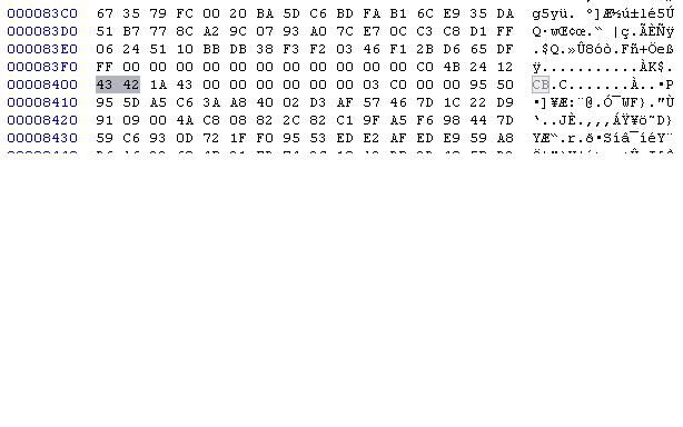

So when you go to 08400 you don't see this:
Excuse the crap screenshot. Your CB in this case would be 1A43. Post a pic of what you've got at this address.

Thats address 8400C, not 8400 wink.gif Dump your whole NAND anyway, just to be on the safe side. Just seen your getting errors. I reckon your LPT/USB wiring might be off, and no it won't harm the NAND to stop reading - it does if you're writing though......
