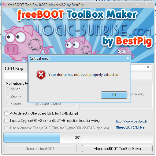

Sorry for the double post, but I can't seem to edit my previous one. This is my exact procedure:
Extract the menu file and flash360.xex
Put both in the root of my USB
Go to xex menu, navigate to USB, and press A on flash360
Press X for NAND Dump
Press A (and B - I've tried both the full NAND and the flashable NAND to no avail)
Once it's extracted, I remove the flash drive
open freeboot toolbox
Enter CPU key, checkbox Jasper 512MB, click generate
It asks me to locate the nand file, and I point it to the root of the USB drive
It gets to 38% and then I get this error:
Could someone let me know what I'm doing wrong?

toolbox only works with original files, do as linsonchan use nand to fb maker instead of toolbox.

« Reply #5 on: August 13, 2010, 12:02:00 AM »
What I did to solve this problem:
Open the nand.bin in 360 flash tool. Hit edit config then click edit then, without changing anything, hit save. Save the file over your original (or if you are really skittish, something else) then proceed to open the file with freeboot toolbox. The progress meter should now blow past that 38% mark without the error.
I don't know why this works but it always did for me.

« Reply #7 on: August 16, 2010, 07:45:00 AM »
The 38% issue I found is sometimes related to the version of windows you are running,  I have better success with XP more then anything. Luckily if you Windows 7 ultimate you can use xp mode.
