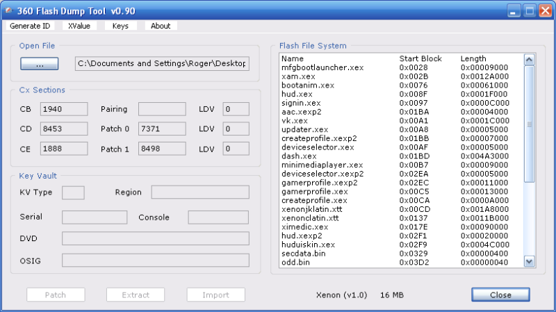

I haven't booted XELL yet so no cpu key, but this is what I get in flash dump tool
the nand isnt too new is it?

You have installed the 8498 dashboard, so no, your xbox cannot run XeLL. CB version must be 1921 or lower on a Xenon for it to work.
